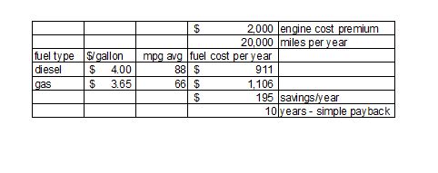

Add the cost of a diesel to the anticipated price of an Elio and it puts it out of the market for many people. The goal is to get this into production. This is supposed to be a cost effective option to higher priced vehicles. Those who have the extra disposable income can retrofit it with whatever they want. What is the return on investment or cost benefit analysis of a gas Elio versus a diesel version?

This is just a quick workup, I assumed 33% more efficiency for diesel, but included todays gas and diesel costs near me. Engine cost premium is usually more, but usually for a bigger engine, but let me know if it is off.
Thanks. I though I had read somewhere on the forum that the cost of the Smart diesel was around $6000. If that was accurate that significantly changes the financial dynamics
