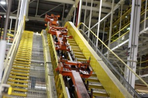

As we mentioned last week, our plant is made up of two separate buildings that will work in unison to produce the Elio: Building A and Building B. Building B, which spans 470,000 square feet, is where the manufacture of the vehicles will begin. The body frame, body panels, and paint processes will all take place in Building B. It is here that the foundation of the vehicle is put together and where the standard for overall quality of the vehicle is set.

The process of building the Elio starts in Building B in what we would classify as a traditional manufacturing process. First, the underbody parts and subassemblies will be set in jigs/fixtures and welded (spot welding) to create the underbody. The welding will be predominantly done by existing robots in the plant – building B will have over 200 welding robots alone.
From there, the underbody is sent along our automated conveyor to attach to the body side apertures. These apertures are set into place at the framing station from the A-pillar to the rear of the body. At this point, the vehicle will begin to the resemble the final product.
Next, the roof is added and then finally the “closure panels” are attached: the hood, door, fenders and deck (trunk) lid. This marks the end of the body in white segment of the vehicle build. This is a simplified outline of the process which includes over 240 total parts put together to make the foundation of the Elio.
