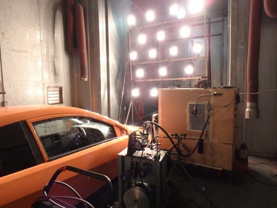

To test their customer’s HVAC systems, RedDOT uses a full-vehicle environmental chamber that is 48 feet long, 18 feet high, and 18 feet wide. The chamber can create environments of scorching heat, artic cold temperatures and a relative humidity ranging from 20% to 95%. Recently, this chamber tested the E-Series’ air conditioning, heating, and defrost systems.
A/C:
To validate the Elio’s A/C system, we begin with extreme conditions. The temperature for the environmental chamber, with the E1D inside, was set at a sweltering 110 degrees Fahrenheit at 40% relative humidity. The vehicle was essentially drenched in heat for 24 hours, and for good measure, a bank of heat lamps using 700 W/m² was aimed at a 30% downward angle to replicate the real-world solar effect. Now, the test can begin and the A/C can go to work.
The A/C test tells our engineers everything they need to know about the distribution of air flow throughout the cabin of the vehicle. From this test, we can ensure that the A/C adequately provides cooling to both the driver and passenger. We also conduct this testing using a 3-level method. That is, ensuring that the head, midsection, and feet of the occupants are cooled equally. This ensures that the driver’s brow is as dry as their feet. The results of the A/C testing were in line with our expectations. Now, our engineers can make further refinements to the vehicle for an optimum cabin experience.

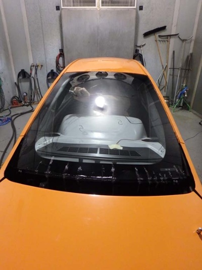

Defrost: As a part of our HVAC testing, the defrost of the Elio was also tested. The test was conducted following the Society of Automotive Engineers (SAE) standard J902.
In the above photo, you’ll find a RedDOT employee making marks on the windshield to chart the actual defrost pattern. Ultimately, the defrost pattern will match the 95-percentile driver eye position. The engineers are very satisfied with the first round of defrost pattern testing.
