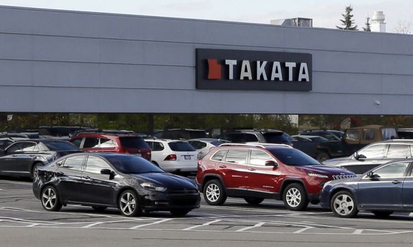

FILE - This Oct. 22, 2014, file photo, shows the Takata building in Auburn Hills, Mich. Scientists hired by the auto industry have determined that multiple factors, including moisture and high humidity, can cause some Takata air bags to inflate with too much force and hurl shrapnel at drivers and passengers. The Independent Testing Coalition, which has been investigating the cause for the past year, announced its findings Tuesday, Feb. 23, 2016. (AP Photo/Carlos Osorio, File)
