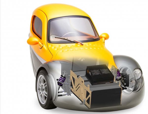

Could possibly spec the battery box used in the Sparrow2. It MIGHT fit in the elio engine compartment, low between the two front wheels for the best center of gravity and low center roll. Could be a very stabile configuration. Front wheel drive in-wheel hub motors or if space permits, independent dual motors similar to the FUVs. EM would need an engineer or 2 on the Marketing Team.
I agree. There wouldn't have to be 300hp motors in there. All the Elio would really need are a pair of 25HP motors and enough battery to give it a reasonable amount of range.
