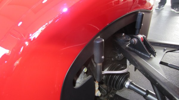

We are often asked if the Elio will come with a spare tire and about the difficulty of changing the tires. Similar to most new vehicles, the Elio will not come with a spare tire. A small percentage of the population knows how to change a tire, and a smaller percentage is willing to do so. Additionally, a spare tire would add weight and cost to the vehicle. We will offer a “flat repair kit” as an option for Elio owners that want that extra peace of mind.
Changing the tires will be easy for DIY Elio owners. To change the front tire, simply remove the four bolts which hold the front fenders on the vehicle for access to the tire. To change the rear tire, remove the four screws from the rear center fairing, then lift and remove the side fairing(s), which has a hook to lock it in. Currently, a technician is able to remove the rear tire in less than 6 minutes.

Good update on wheel specifications, which I am sure many people were interested in hearing. Two points that I enjoyed:
-Seeing the thread design of the front/rear tires, and see how they differ between the two.
-Seeing another subtle improvement. "To change the front tire, simply remove the four bolts which hold the front fenders...". Four bolts. On the P5, there were only two bolts holding on the fenders. This problem arose during a test drive interview, where the fender fell off. So I am glad that Elio saw the issue and made corrections to strengthen the design.
