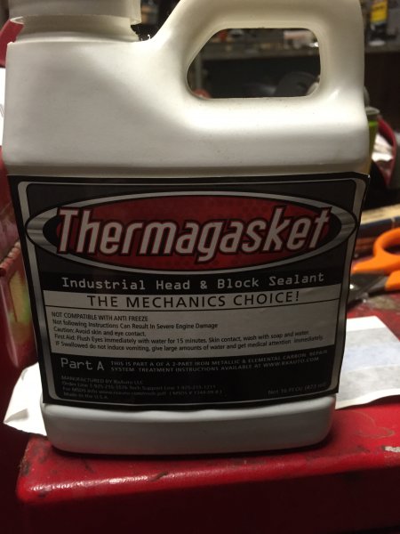

Jeff , I found a " temporary" fix that worked . 2 Things are happening . The NorthStar studs get loose and the inherent high pressure of the cooling system . White smoke from exhaust , excessive engine heat and coolant levels that need to added each week . I researched and purchased this product . It is a 2 part process . The 1st involves a simple pressure release value installed between coolent tank and radiator . The 2nd is an epoxy sealant that seals the gaps between the head and gasket. I am NEVER in favor of a liquid mechanic but my son was unwilling to spend thousands . I know you don't know me , but I assure you it is the best $150 you will spend . Once process was complete , all symptoms were gone for over 3 months . He traded the car in for a new jeep therefore we never determined if the fix was permanent .
https://www.rxauto.com/faq.htm
