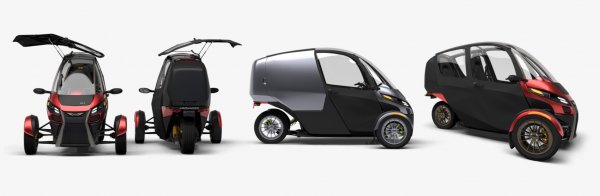

Side panels allow for open or enclosed riding to include climate control on the production model. There will also be an enclosed single seater Deliverator SRK.

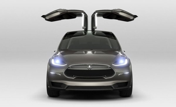

Maybe Tesla should've copied the SRK's nice door design for their Model X. Would've been simpler, I think.
