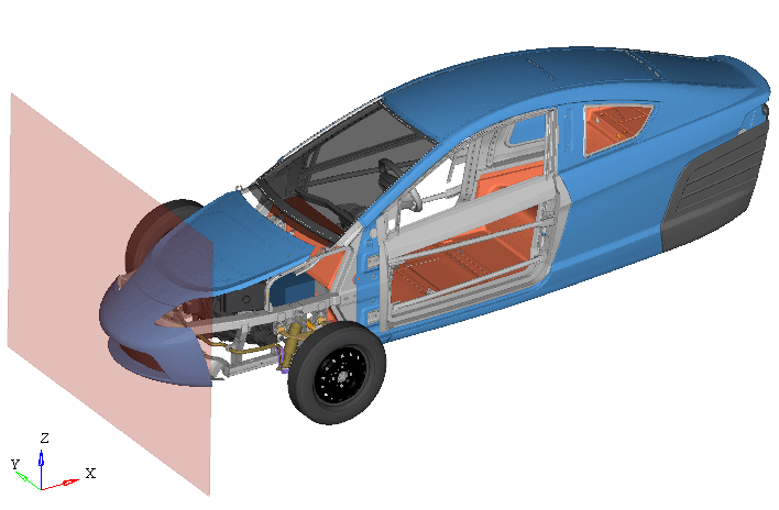

CAE impact simulation - front view

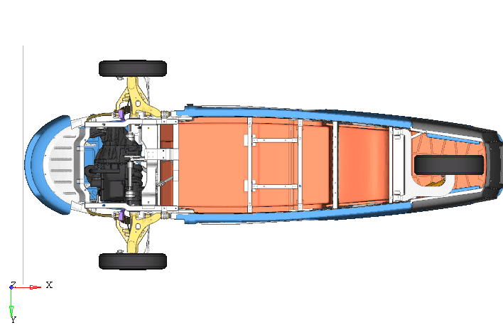

CAE impact simulation - bottom view

I love these simulations. It is also good to see the underside design including front and rear suspension.

I am fascinated by these computer simulations where they show the design of the vehicle and how it deforms in the event of a collision. I assume they also have underside views of side and rear collisions. I would like to see those too.
The underside view show the anti-sway bar mounted very far in front of the engine. Is this to allow removal of the engine from the bottom without having to remove the sway bar? I doubt they are that considerate of people who work on vehicles. What vehicle manufacturer is? (Has it been stated if the engine comes out the top or bottom?)

The above simulations were on a display monitor @ the Elio display in the Greenwood Park Mall in Indiana this morning.

Notice how both a yellow coating on the suspension arms and interior carpeting help dissipate the collision energy. I hope EM uses these results to inform the inclusion of a standard safety package built around use of yellow paint all around and plush interior carpet. :rolleyes:
