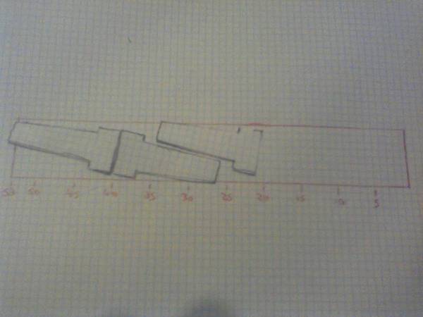

I'll concede 4 flat on the floor. 5 is close, and might go with actual dimensions that we don't have.

I'd like to see how you'd load 6 Elios on a standard, enclosed semi bed. The maximum inside width of a standard "wedge" trailer is 99 inches. The inside height is 110 inches at the read and 109 at the front. Length varies from 45 to 53 feet. The width of the doors is 93 inches.
Each Elio is a trapezoidal solid with the following dimensions: Overall Length: 160.5″
Overall Height: 54.2″
Front Wheel Track: 66.8″ (let's assume that's the widest part, ignoring the wheel covers which make the width actually a couple of inches wider)
(center rim to center rim)
I don't know the body width at the rear but it can't be less than 30 inches.
So: how many Elios can dance on the floor of a truck? You can't stack them, they're too tall. Taking the largest trailer, 53 feet, you have room for three Elios -- actually 3.975, but sorry, you can't squeeze that extra little bit in unless you were tail-to-tail as you suggest. But even so, my guess is that the max load on the longest trailer is only 4 Elios. To really answer this, you'd need to know how quickly the rear quarter of the car tapers down to minimum width, because that gives you the amount of overlap you could have. Maybe you or one of our good gear head guys could really work this out accurately, but I'm willing to bet 5 would be the absolute upper limit, and that's pretty unlikely. 4 is the probable upper limit.
Don't forget, you have to have working room to secure the vehicle in the trailer and then get in the thing to unload them. If they're overlapped, that might be hard to manage.

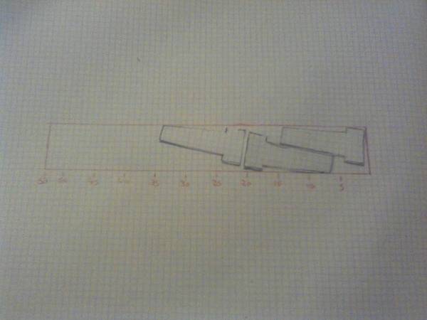

1st 3 loaded - 8x53 " trailer"
A little game of hopscotch, and my estimates are off:
With palletizing 2 side by side without front wheels, 6 would work easy. Wheels removed MIGHT make 2 high stacks possible.

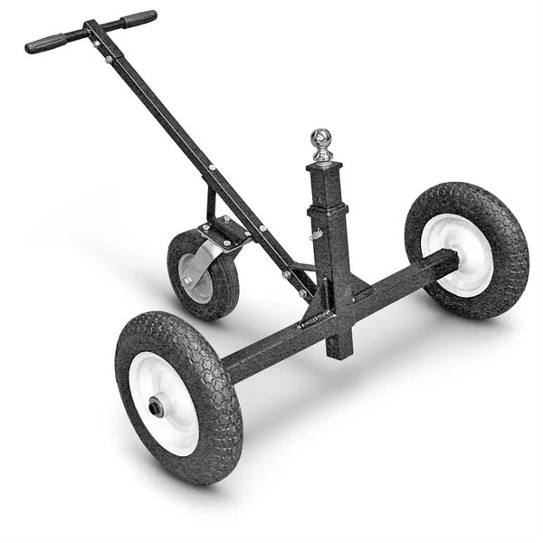

At 1200#, one of these that fit a notch in the back of the frame would maneuver Elios on and off a trailer pretty easy. They're made to move boat trailers etc around the yard without a vehicle.
Since they have a lot of them to move the muscle man version would be out and they go with something more like this Parkit360
