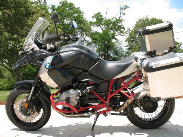

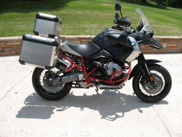

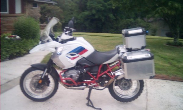

I've stalled out on the Audi UTE, but I still keep busy.
I have had this for a few years and I was getting tired of the looks.
So I found some used plastic and wheels,, and did this!
I LIKE IT!
