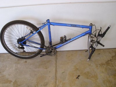

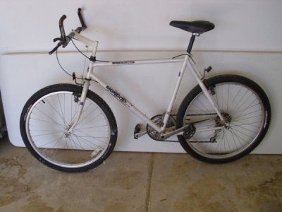

My road bicycle just isn't built for pulling a cargo trailer for my larger grocery store runs. Between the gearing and the skinny tires, its quite difficult. And with the price of gas hitting $4.69/gallon -- I'm not taking the car out.
So... I've been keeping an eye out for a larger frame mountain bike. I found one at Goodwill (this past Friday), albeit in pretty rough shape. I didn't pay much for it (LOL)!!
Today's project was taking two broken bicycles and making one good one. I was given the Blue Bike and was thinking about fixing it up, but the frame was too short for me. So, I took the best pieces and made a somewhat functional mountain bike/cargo hauler. I still need a better shifter for the rear derailleur and need to install the cargo trailer coupler. But I'm looking forward to taking it out for a shake down run.

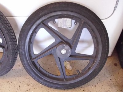

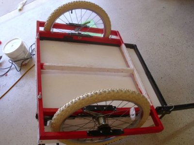

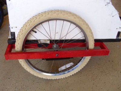

In an effort to avoid paying $5/gallon for gasoline, I've been using my bicycle for almost everything. My bicycle cargo trailer has been getting quite the workout. Unfortunately, the plastic rims are warping. I don't think its the weight and its not that hot, yet. So, I have no idea why the rims are warping/bending. This was originally a kid bicycle trailer that I up-cycled into a cargo trailer.
Any way, I purchased a busted up children's bike at Goodwill. Nothing on it was any good, except the rims and tires (which is all I really needed).
So I built a new under carriage / cradle that would accommodate the larger/stronger wheels. All of the wood and metal is scrap from various other projects. I did have to purchase long bolts to mount the cradle to the cargo box, but that was only $6.

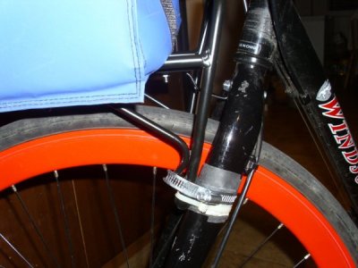

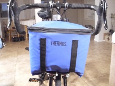

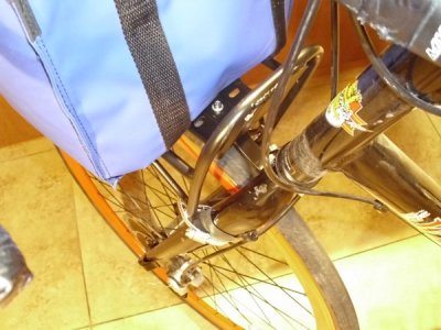

As gasoline prices hover around $5/gallon here, I've been using my bicycle(s) more and more for day to day errands (including grocery shopping). So much so, that I figure I could justify the cost of a front rack on my road bike ($11 on Amazon). I found the soft cooler at Goodwill for $2, so I didn't feel bad about poking holes in it and zip tying it to front rack. I did have to use hose clamps for the lower supports, as this road bike has no attachment points. I don't think it was ever meant to be used this way.
Now I can put a gallon of milk, etc. up front and ride on home.

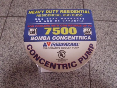

Yesterday afternoon, my girlfriend came to me in a panic and told me hot air was coming out of the vents. So, I went and checked our Evaporative Cooler and the pads were dry -- the main water pump had quit. I wasn't really surprised as it was about 11 years old -- a good run for a small pump.
I came back in and told my girlfriend the main water pump failed. Her response was "Who do we call??" My answer -- we call nobody. I went to my stash of spare parts and pulled out a brand new pump I kept in stock. 10-15 minutes later, the cool air was restored and she was happy.
I saved the box, so I could purchase another one to go back in stock for the next failure (10 or so years from now).
When I went on Home Depot's website, the price had doubled since I purchased the last new one ($25 to $50). I checked on Amazon and they have one for $40ish, so I'll use my credit card points to get it at a slightly lower price.
