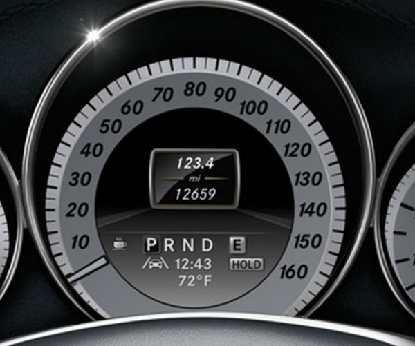

I came across a Mercedes-Benz C250 the other day. The center of the speedometer contains a digital display, meaning that the needle that points to the vehicle speed is mounted to a ring around the circumference of the speedometer. While I have no idea if Dakota makes the C250 dash, this same mechanism could be used to mechanize the Elio dash. Because the Elio dash only has to be lit in the viewable window, it probably doesn't require the multiple LEDs to keep the needle in the Mercedes-Benz dash uniformly lit as it travels around its circumference. This ultimately saves money, even if it's only pennies.
