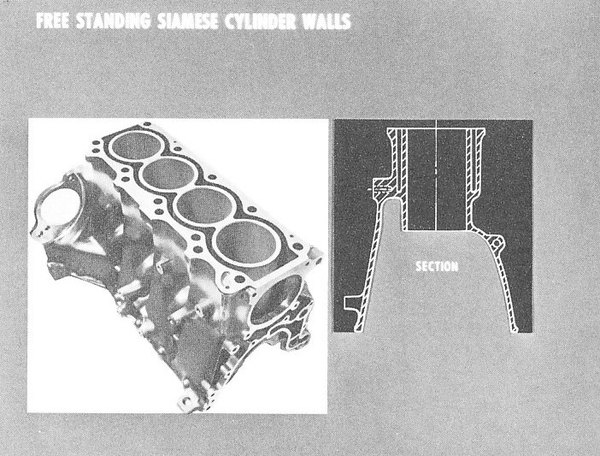

Im a little concerned about the longevity of the engine. Its an aluminum block with no cylinder sleeves. Instead, they are plasma-sprayed, but plasma sprayed engines haven't been around long enough to really know how they hold up over time.
I think Ford introduced Plasma-sprayed cylinder linings in 2011.
Plasma sprayed cylinder walls of the engine are suppose to have long life. That technology has been tested and proven.
However, the same thing was thought of the silicone impregnated walls of the Vega. That technology had also been tested and proven.
But if you think back, Vega cylinder walls were free standing and fit into cast iron heads.
Over heat the engine and it warped the head. And bang! Compression is gone.
So it wasn't the silicone impregnated walls.
It was the aluminum block and cast iron head with different expansion rates.
