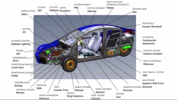

Where would the exhaust pipe be placed if it goes to the back of the vehicle? The floor where the feet are placed will be made of composite material and placed on top of the floor cross members. A composite panel is considered for placement below the cross members to reduce drag and improve MPG. If both panels are present, where would the exhaust pipe to the back of the vehicle be placed?
The use of composite materials for vehicle floor pans and/or aerodynamic undertrays is actually fairly common as automakers have been using both for some time now to increase fuel efficiency via weight reduction and aerodynamic improvements. As a result the exhaust heat issue is both well understood and easily resolved via the use of heat shielding materials. These materials can wrap the exhaust itself and/or be attached to the underside of the floor-pan and to the parts of the aerodynamic undertray which comes close to the exhaust. These have been proven to effectively dissipate heat enough to protect composite materials from damage.
So to answer your question the Elio exhaust will run under the vehicle along the right side frame rail. While you can't see that portion of the exhaust on the image below you can see the green exhaust running to and from the the right side at the front and back of the vehicles.
Thanks. Great picture. Where is it? I checked and it is not in Instagram. In fact, all the old pictures on Instagram are now gone.
The image is actually a screen capture from the Investment Opportunity Video which was released last month. It is a very nice image as it actually contains many new details including the showing the updated chassis and exterior designs we had been expecting along with listing a number of suppliers we did not know about before.
http://www.eliomotors.com/investor-inquiries/
As the forum software cuts the image size down I have a larger version linked from my Google drive. The image is a bit fuzzy however this is due to it being a screen capture from a streaming video. I have actually asked EM if I could have an original version of the image however so far have not had luck getting hold of it. :D
https://drive.google.com/file/d/0Bxh8JmkBAL7wbXVPU1VLQnlfU00/
