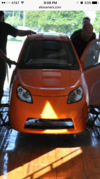

What's the problem?
The high beam looks to be within 8 inches of the low beam.

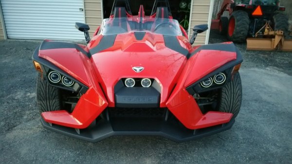

The Slingshot doesn't seem to have an issue with this, maybe because they interpret the FMVSS language as allowing a dual hi/lo beam arrangement like the Elio's:
What's the problem?
That's not what it says. The headlights themselves are not supposed to be more than 8" apart if it's designated as a MC by the feds.
This line is the key.
Paragraph S10.17.1.2.2 (applies only to the subject vehicles manufactured after December 1, 2012).
"If the headlamps are horizontally disposed about the vertical centerline, the distance between the closest edges of their effective projected luminous lens areas must not be greater than 200 mm."
It doesn't say that the MCs mfg. after December 1, 2012 must horizonally dispose the headlamps about the vertical centerline as those mfg prior to that date are required to do, it says "IF the headlamps are..."
The important part is are the placement of the headlamps considered to be "horizontally disposed about the vertical centerline" or not by the Feds.
How could you dispose them in any other way other than to be, "horizontally disposed about the vertical centerline"? I mean, they're equally distant from the centerline of the vehicle, right?
I'd already looked it up. The Slingshot's got two lights in the center that are less than 8" apart.
Looks like they were covering all the bases ahead of time.
