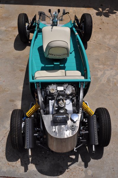

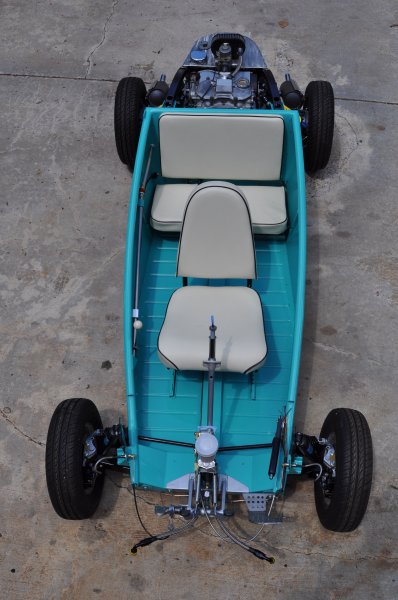

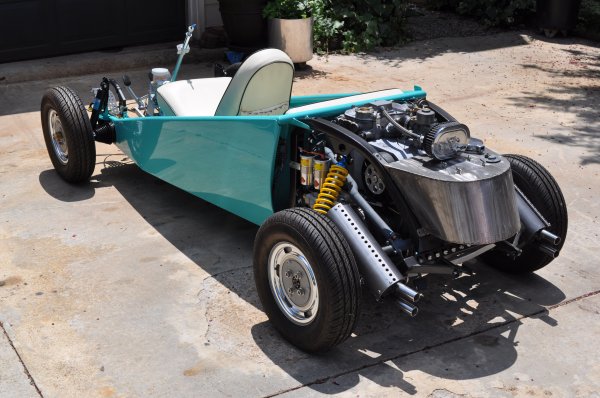

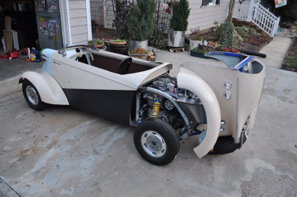

DONE & DONE !
THIS ISN'T REALLY A COMPARISON OF THE VEHICLES SO MUCH AS THE TIME FRAME .
THE ELIO IS A MODERN CAR & THIS ONE IS A BRAND NEW ANTIQUE .
THE CAR HAS ALREADY HAD THE BODY FITTED & FINISHED .
THE OTHER PIECES ARE STILL AT THE PAINT SHOP GETTING A COAT OF TURQUOISE .
I AM AT THE STAGE WHERE YOU TAKE IT APART FOR THE 10th TIME
AND PUT IT TOGETHER AGAIN IN A (HOPEFULLY) FINAL ASSEMBLY .

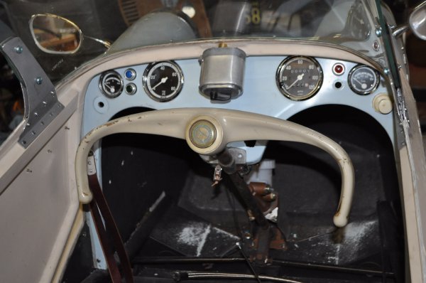

STEERING WHEEL AND DASH ? IT HAS THOSE TOO !
IT HAS A CONVERTIBLE TOP FRAME BUT I HAVE NOT HAD THE FABRIC SEWN YET .

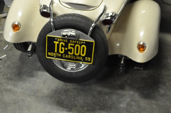

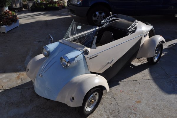

IT IS TITLED AS A 1959 MESSERSCHMITT . THERE WILL BE NO AIR BAG OR AC .
AND THEY ONLY EVER HAD ONE DOOR THAT FLIPS UP AIRCRAFT COCKPIT STYLE .
THE MOTOR CAME FROM A HONDA z600 COUPE THAT WAS 600 POUNDS HEAVIER ,
COULD HIT 85mph AND GOT FUEL MILEAGE WELL INTO THE 60+mpg RANGE .
MY CAR IS 8" NARROWER AT THE WIDEST POINT AND WITH TANDEM SEATING
CUTS A MUCH SMALLER HOLE THROUGH THE AIR .
YOUR BENCHMARK OF 70mph & 70mpg WILL BE A PIECE OF CAKE .
OH YES , IT HAS HUB CAPS & A SPARE TIRE TOO .

THE REAL TG-500 IS A BIG MONEY CAR THESE DAYS .
IT TAKES $100,000 TO LAY YOUR HANDS ON A RESTORABLE EXAMPLE
AND HALF THAT MUCH AGAIN FOR A NICE ONE .
I AM NOT THE FIRST TO TRY RE-CRATING THE CAR BUT WITH PRICES LIKE THAT
AND JUST 130 KNOWN SURVIVING CARS THAT RARELY CHANGE HANDS ,
BUILDING MY OWN VERSION WAS MY ONLY OPTION .
SO I PUT MY SKILLS TO WORK . I USED THE HONDA z600 ENGINE BECAUSE IT
CAN FIT IN THE CAR , IS AIR COOLED AND ALREADY GEARED FOR 10" WHEELS .
IT HAS A FULLY SYNCHRONIZED GEARBOX AND 15 MORE HORSES THAN THE ORIGINALS .
MANY OF THE PARTS HAVE BEEN SOURCED FROM OVERSEAS AND I HAVE USED
ORIGINAL PARTS WHERE POSSIBLE .
I HAVE INCORPORATED A FEW OF MY OWN IDEAS .
MOST NOTABLY , IT HAS A TILTING TAIL SECTION . THIS HAS NEVER BEEN DONE
AND REQUIRED SOME CHANGES TO THE TUB & TAIL SECTION .
CABLE & SHIFTER ROUTING WAS A NIGHTMARE .
I HAVE A PLACE IN LINE FOR TWO ELIOS & THIS IS WHAT I AM DOING WHILE I WAIT .
WHAT WOULD I SELL IT FOR ?
NOT SURE YOU MAY GET A PRICE FROM MY WIFE AFTER I AM GONE .
OH LOOK , HERE IS ONE ON E-BAY FOR $24,000

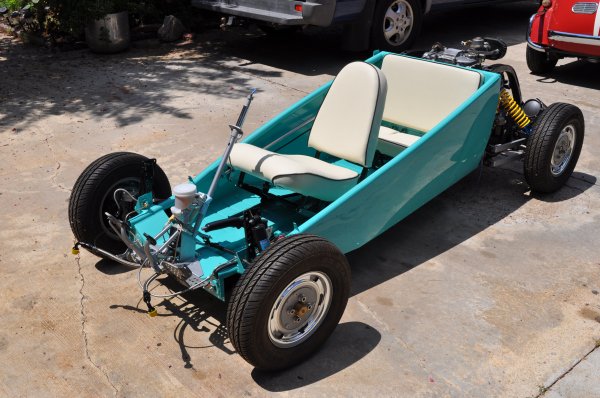

It does not look much like a tub once the body panels are in place. Well done.
