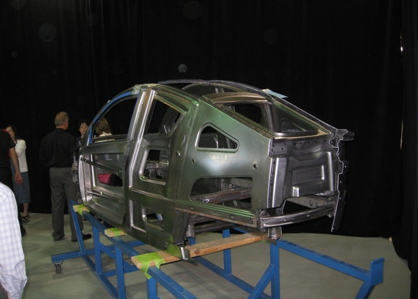

On the right rear corner, what is the vertical metal piece welded to it?
There is no corresponding piece on the left rear corner.
11,100
16,396
That's because it's an external body panel; they did say they were going to test and evaluate it; and that is a frame intended for the E Series test Elios.
I don't think it's welded on, and if you look closely on the inside corner it isn't necessarily metal. Looks a little like a composite.
Enlarge the picture to about 600% and take a closer look at it; I don't think you could stamp that internal attachment point, and it's part of a mold process.

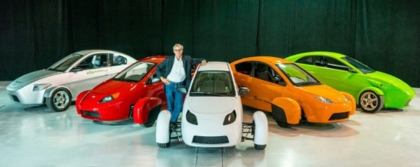

Paul Elio and E1A and Prototypes – All of the prototypes of the Elio, including the E1A E-Series engineering vehicle (center, with Paul Elio), feature SMC molded body panels, which are well suited for low-volume production.

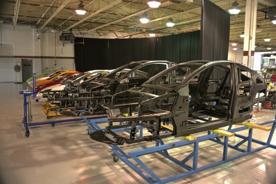

All 6 Versions of The Elio – The P-Series prototypes all had tubular frame construction, but the E-Series engineering vehicles have evolved to feature unibody construction, which the Engineering and Manufacturing teams have deemed a better choice. A similar evolution is occurring with body panels from SMC to galvanized steel.

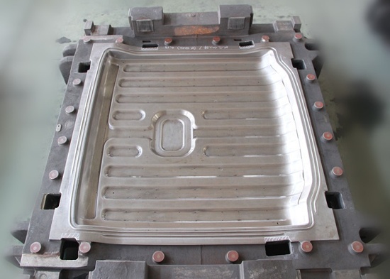

Metal Stamping on Die – For high-volume production, steel stamping is much more cost effective for body panels than SMC. Galvanized steel also will hold tolerances better for a more precise finish.
