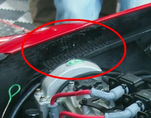

The P5 is still a LONG way from production. Look closely at the large pictures posted by Autoblog. The body panels are held to the frame by glued-on and tack-welded perforated steel. The radiator has inlet and outlet on the wrong side. No hood latch. Climate control screwed to the dash with visible phillips-head screws. The random hoses and clamps plumbing the engine. Cable ties holding the plug wire boots onto the coils. The list goes on.

John, did they explain the perforated metal used to attach body panels to the frame? I don't think that's going to work for the engineering versions, much-less production. I'm curious what the actual solution is, and why that isn't on the P5. I'm sure they have one but the fact they didn't use it says the panels aren't quite production-ready yet, and it's why the P5 still looks "rushed" to me.
Actually, if you want to permanently attach a composite panel to a metal structure (or vice-versa), perforated metal attach points (hard points) is exactly how you want to do it to mechanically 'lock' the dissimilar materials together. Adhesives have come along way, and depending on which type they go with (UV activated would be my guess) the bond would take seconds to attain a full cure. Robots could apply the adhesive, position the panels, and zap them with UV...securely attached, off to the next station. Even if you wanted to make the panel removable (bolt-on), you'd still use the same method for attaching the nut plate/bolt plate to the composite skin/panel.
That's all reasonable, but I'm talking about the perforated metal on the P5.
It is just tack-welded to the frame. That is not production ready.

Now I see what you were referring to. Yep. Not production ready.
While you guys are right, it does give them dimensions for the final mounting brackets, likely a steel "L" bracket that would attach to a nut molded into the fender and a hole with a self tapping bolt on the frame side, to give some adjustability.
