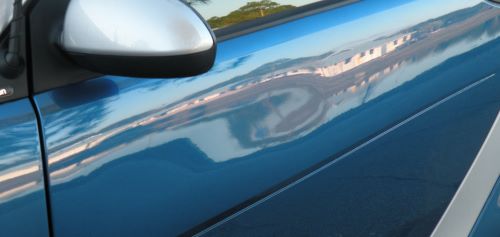

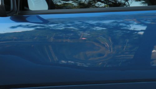

Some caveats for you all to consider. When the smart came to the US in 2008, a number of owners immediately set out to improve the acoustics by applying Dynamat and other sound deadening materials. In several cases, applying the Dynamat directly to the inside surface of the plastic body panels resulted in very noticeable warping in situations where the car was subject to warm climates.
I posted my theory at that time which seemed to explain the phenomena:
According to this article, plastic door panels have a high linear coefficient of expansion (relative to steel) and must be able to expand in two directions:
Quote:
Expansion and Contraction. Plastics suppliers have had less success in overcoming another traditional problem–the pronounced expansion and contraction plastic panels undergo during temperature extremes. Plastics have a much higher coefficient of linear thermal expansion (CLTE) than steel, and therefore require more space to grow and shrink. This leads to wider panel gaps than most automakers, driven by quality survey results to eliminate fit-and-finish concerns, are comfortable with. The problem can be ameliorated on fenders and side panels by firmly securing them where they meet the door and allowing them to expand in only one direction. But that doesn't work with doors, since they have to be free to expand in two directions. Plastics CLTE has been reduced in the newest formulations by tweaking blends and adding mineral fillers, but it is still nowhere close to steel and no one really expects it to get there. GE Advanced Materials' Aoki says that gaps can be successfully managed through clever design, and he points to his company's extensive design work on smart's plastic-paneled lineup as proof. But like Saturn, smart's vehicles are designed from the beginning for plastic use, and it's unlikely that automakers will be willing to upend their design processes in order to accommodate the vagaries of polymer doors. Indeed, fenders and side panels are seen as a growth market for plastics precisely because special handling has been eliminated.Feature Article - Sensors Make Sense - 06/04
So perhaps what's happening is that your use of foil-backed and non-foil-backed Dynamat creates enough of a thermal gradient in your door panels while they are sitting in the sun to cause the denting. Because the plastic has to expand in two directions, and the temperature gradient creates two different regions of thermal expansion, the end result is the puckering or dents that you're seeing. Just a theory.
I recall some smartcar forum members recommended the use of the foil-backed Dynamat, rather than the non-foil Dynamat, to avoid this situation when applying the material to the inside surface of a plastic body panel. The recommendation also said to make sure you cover the entire inner surface of the panel to avoid creating pockets of thermal gradients. I'm not sure if that was a successful approach although the basis for it seemed sound. FWIW and YMMV.
