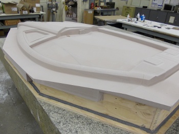

Left Hand Side Body Panel – Pattern cut ready for benching and seal painting to bring the surface up to class-A finish.

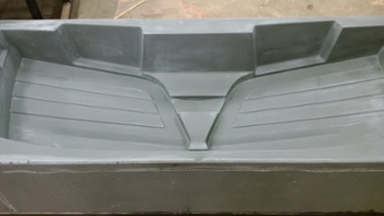

Rear Left Hand and Right Hand Skirt Tool Complete – ready for mounting to vacuum form base.
