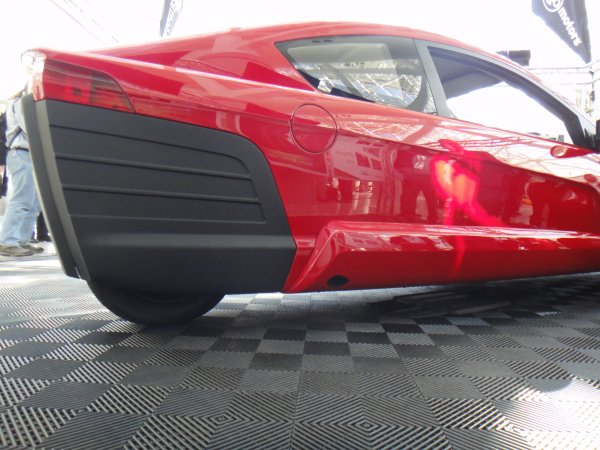

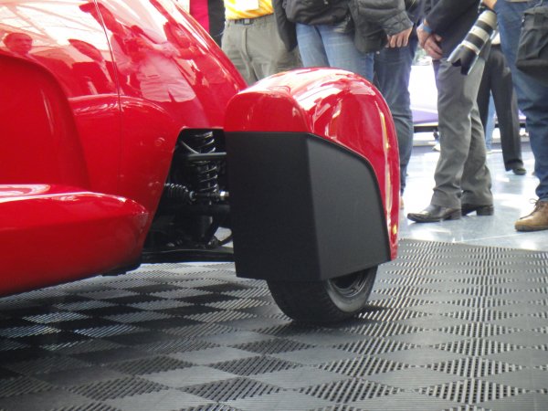

I do not know why the back of the vehicle and fender skirts are square. For aerodynamic purposes, I would think they would be rounded and more tapered.
This is the big mistake often found in 1950's 'aerodynamic styling', a curved rear surface that goes beyond a certain angle, does two bad things, draws a lot of air in then makes it all turbulent. It's also often unbalanced compared to adjacent air which can generate vortexes in addition to turbulence. These are the reasons that motorcycles aren't much better than cars in MPG and why the right Vetter Racing fairing can bump the well-prepared (gearing) bike as high as 200 - 450mpg.
But you are right about tapering, as long as it doesn't exceed 12 to 20 degrees of angle. The slope of the Elio 'fast-back' is perfect.
Yup, you can see what I think the balance between styling and tear-drop shaping should be, just looking at my avatar image.
I should say something with respect to the Elio about zone balancing(my term).
Since the air behind the exposed aarms is some what disturbed tapering provides less of a benefit. Once a bit disturbed, tapering can amplify that into big turbulence. What they likely had was a bigger need to make sure the air over the back was not unbalanced compared to the air from the sides.
My covered suspension is more difficult to implement, but it frees the design to focus on tapering and less worry about unbalanced air 'zones'.
My concern was not function but aesthetics. The skirts look cheap, couldn't they add some structure and eye pleasing ridges in them like they did the back panel? It just looks cheap like it's made out of cardboard.
