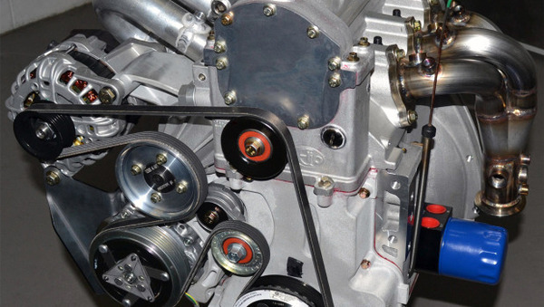

Don't see the AC compressor. Not installed yet, or are they leaving it out of the P5?
If you look at a good picture of the engine you will see on the left of the picture, top to bottom, the alternator, water pump, and below that the A/C compressor. Looking at the installed engine picture, you can see a part of the alternator. Best practices would say that you wouldn't install the alternator if you had to rip it out again to put in the compressor and water pump.

I can just barely see the back of the water pump too, but yea, no AC compressor is visible in these picture angles.

Usually, it won't be until they're ready to install the rest of the A/C system all at once(condenser, evaporator, drier, orifice tube or expansion valve, and hoses). It avoids contamination.
Now I see they already have a serpentine belt installed. These pictures are horrible angles which don't give us a view of the front bottom side of the engine (where the a/c compressor is tucked under, see pic below). For all we know, it could be on there.
The pulley with the "triangle" in the center appears to be the A/C compressor.
