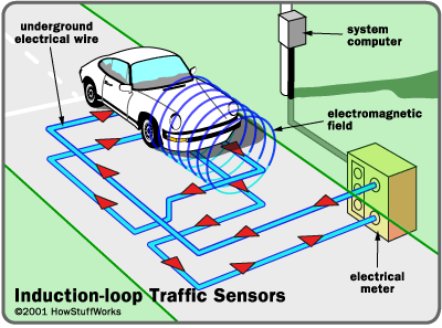

TL;DR - Elio will have no problem at traffic lights for people who understand how they are triggered.
Some are triggered by cameras, but most are triggered by induction loops that are sensitive enough for a bicycle to trigger them.
It's very annoying when people don't understand how traffic lights work and don't pull up to the light on top of the sensor loop. The loop is generally very obvious:
But you have to be on the loop for it to trigger. There's a turn signal on my way to work that people routinely completely miss the loop and we sit there through a complete cycle. I have to go around them or try to pull up as close as I can and get my car over the sensor.
Here's how they work (the image is a link):
