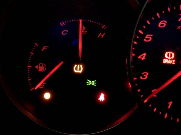

And how else could I get an awesome shot like this? :D Notice the car is still running. No, that is not parallax error.

Holy crap! Low tire, too! Does it always idle at 2,000 RPM at a stop? I'm assuming you are stopped because the emergency brake is either on or you are low on fluid. Any crud in the gas tank will be at the bottom. That last 1/4 tank of gas is what clogs up filters the fastest. You really should keep some gas in the car at all times. What happens when the zombie apocalypse starts?
Also in-tank fuel pumps overheat when they are not fully submerged..

Not a low tire, a useless TPMS system. I run aftermarket wheels without senders. There is no way to disable the useless indicator.
Idle is fine. My foot was holding it at 2000.
Your fuel intake is in the very bottom of the tank. That's the way it works. The "last 1/4 tank" is an old myth from the carburetor days. All the gas in the tank goes through that "last 1/4 tank" before it gets to the pump. It all gets mixed-up too over every bump and around every corner.
I have gas in the car. It's still running! :D
Because there are too many lawyers in the world, gas gauges on modern cars are wildly pessimistic.
At this fillup I think I put in 14 gallons in a 16 gallon tank. Yes, nearly all 16 are usable. So I still had more than 30 mile of range with the gauge two needle-widths below "E". No, it's not broken.
If the zombie apocalypse comes, I have other mechanical devices more capable of dealing with the horde.
Only if they are run dry. The fuel through the pump cools it too.

Well said. Some TPMS's work based on the antilock brake sensors. Some work on those senders in the tires. Still others work on cap sensors. Any way to take 4 sensors and connect them to the car without putting them in the wheels? Fake out the car, so to speak?

Which happens soon after that light comes on....

http://www.agcoauto.com/content/news/p2_articleid/195
That's a good primer on pumps and the last sentence says "Do not purchase fuel while a tanker-truck is filling the station tanks. This can stir debris that has settled in the tanks. Another factor is not allowing the tank to fall below one-quarter. Keeping the tank above this level can greatly extend the life of the fuel pump."
