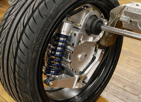

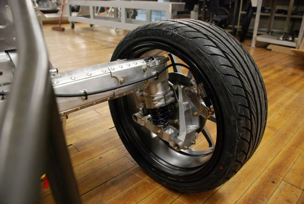

I really like Edison's in wheel suspension technology. I would love to see EM implement this in a future model.
Seems to have more unsprung mass, though.
Actually this design likely reduces unsprung mass. The enclosed I-beam cross member is part of the chassis and the upper part in the wheel where the top of the coil-over shock is connected is not unsprung as it is bolted directly to this chassis element. The unsprung mass is limited to the wheel hub and the pivoting control arm along with the wheel and tire.

Looks can be deceptive. The bottom of the coil over is mounted half way between the pivot point and the connected end. The two inches or so you see that can depress, is twice that much at the end. I see five to six inches of travel there.
it looks to me like any movement of the car up would make any suspension travel hit the upper side of the wheel and anything more than, I'll agree there is probably some leverage at play there, say 4 inches and you'd hit the bottom of the wheel.
