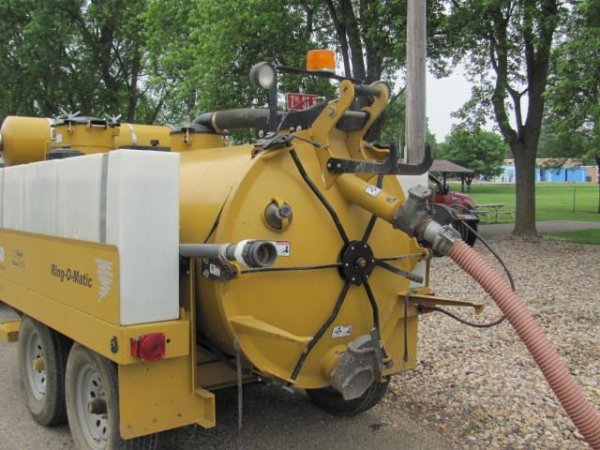

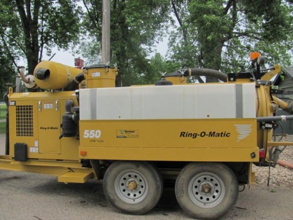

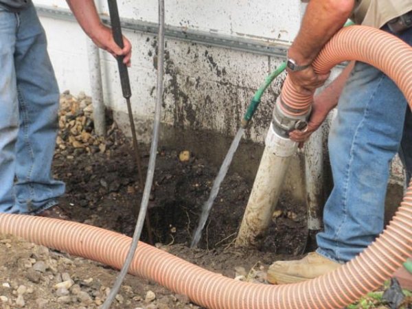

I think I've found just the piece of equipment you need to deal with the nuts .... the brought it into the CG today to find a leaking pipe that is burried among some serious power lines .... all you'd need to do is put some water down the vent pipe and then use the magnum suction to vacuum out the nuts .... only thing, they said the rig cost about 40 grand .. :confused:

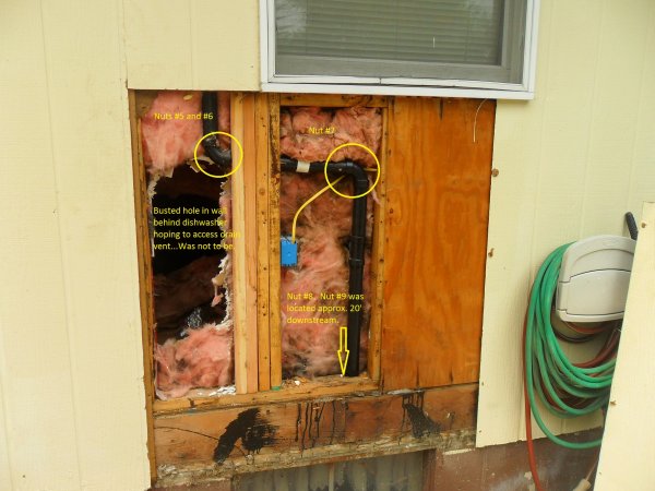

Well...Success!! After 7 hours of tearing my house apart and putting it back together the sink is draining perfectly [and the crowd goes wild!] I didn't get a pick of the hell hole where the last of the dreaded black walnuts was. Wasn't having any fun at all at that point in the process. But here's a descent pic of the demolition required to retrieve nuts #5 thru #8 , #9 was located 20' downstream from the arrow [hell hole]. What a pain in the a$$!
