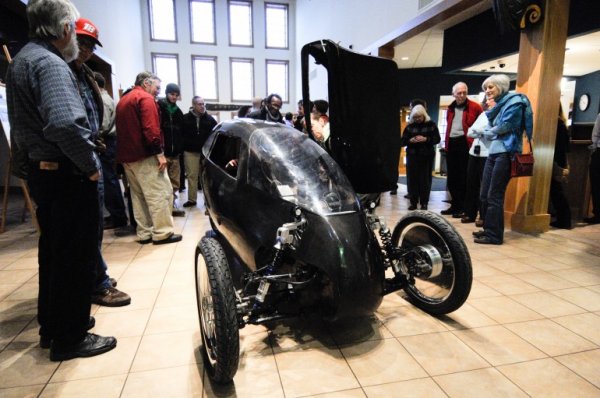

    Technically, the whole Elio could be converted to pedal/electric hybrid power, though an even lighter frame would be better of course and financially that would not make much sense (but the technology is there). The power required depends on weight and aerodynamics, the more those two can be improved the less will be required, same as with ICE based vehicles:
    Raht Racer velomobile may let riders pedal “as fast as a car"
    http://www.gizmag.com/raht-racer-velomobile/36222/

    Technically, the whole Raht Racer could be converted to ICE power, though a HEAVIER frame would be better of course and financially that would make sense (the technology is there). The power required depends on weight and aerodynamics, the more those two can be improved the less will be required, same as with pedal based vehicles: ;)

    Converting pedelec vehicles to run with combustion engines would not even remotely make sense… ;)
