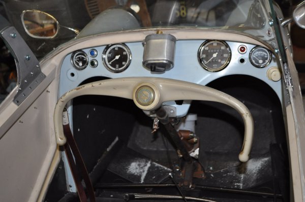

THANKS ! REAL TIGERS DO NOT HAVE THE FUEL OR TEMP GAUGES .
THE ONES I AM USING ARE VINTAGE VDO & TOOK QUITE AWHILE TO FIND .
LORD ELGIN GAUGES WOULD RUIN THIS CAR .

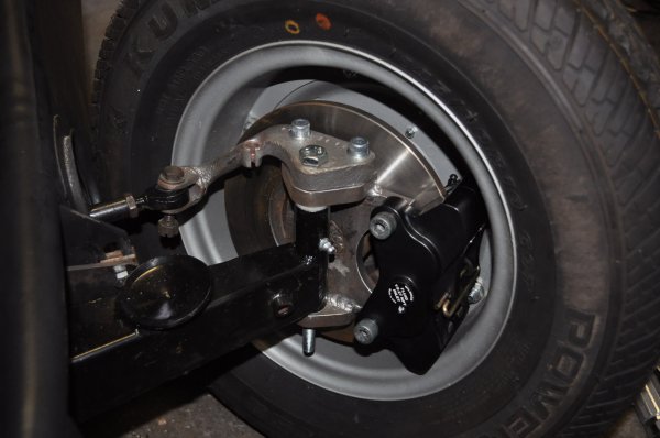

YOU COULD NOT POSSIBLY FIT BIGGER BRAKES INSIDE A 10" WHEEL .
THE DISCS ARE FROM AN MG MIDGET TURNED DOWN 1/2" SMALLER DIAMETER
AND THE CALIPERS ARE WILWOOD 4 POT UNITS .
For a vehicle that weight those are plenty of brake for it.
They originally came with drum slow downs (for the way they worked, I can't call them brakes) didn't they?
Those little disks are going to just about stand it on it's nose if you slammed on the peddle. :D

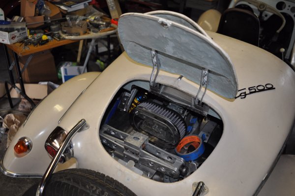

I AM HOPING IT WILL SLAM ON IT's NOSE SMOOTHLY . THERE IS NO POWER ASSIST .
THE HONDA 600cc COUPE THAT THE MOTOR CAME FROM COULD DO 85-90 mph FLAT OUT .
I DON'T THINK MY TG WILL BE ANY FASTER ON THE TOP END BUT IT WILL GET THERE
A LOT MORE QUICKLY .
THE POINT IS , I CAN DRIVE IT ON 540 & KEEP UP WITH TRAFFIC .
MY OTHER MESSERSCHMITTs CAN'T DO THAT .
WITH THE LIGHTER WEIGHT AND BETTER AERODYNAMICS THAN THE HONDA 600 ,
I THINK I WILL SEE FUEL EFFICIENCY IN THE 70's .
THE ELIO WILL BE BOTH FASTER AND GET BETTER MILEAGE .
