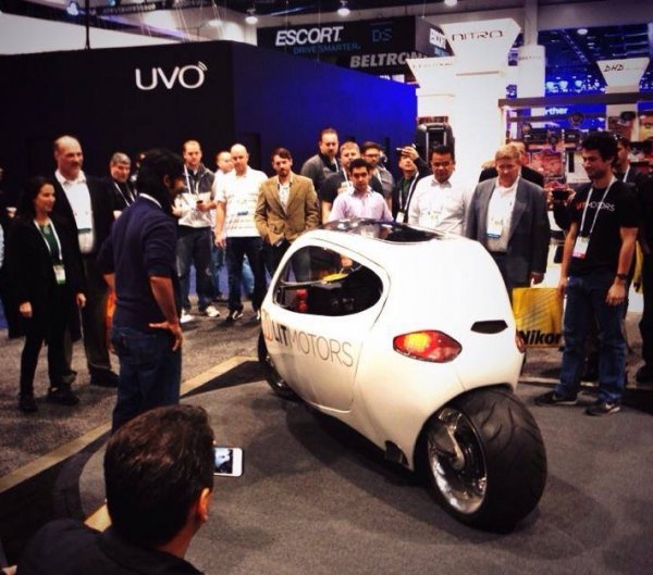

The new draft MC licensing legislation defining autocycle should read enclosed cabin two or three wheel motorcycles to avoid having to modify the law a second time for the Lit Motors C-1.
That is going to be a problem Lit Motors will have to work out for themselves in many states. The AAMVA best practices recommendation only applies to three wheelers and EM's chosen autocycle definition is even more restrictive than the AAMVA recommendation. EM has purposely chosen to define autocycle very narrowly, in such a way that excludes most other vehicles, in order to try and avoid as many points of objection as possible thus increasing the likelihood of success in passing the proposed legislation. It is however highly likely that over time the definition of autocycle will be amended in many states to cover more vehicles.
In Georgia we do not have an autocycle category of vehicle and in some ways this makes it better for us as each piece of the puzzle is defined separately. Trying to do it this way in other states would likely be more complicated which is why EM has chosen the autocycle route in most states.
Georgia already has a helmet exemption on the books for enclosed cabin motorcycles and the definition for motorcycle vehicle registration states any two or wheel wheel vehicle is a motorcycle except for a few well defined exceptions. The way the drivers licencing law works in Georgia is that our class C normal drivers license is the default license needed except for certain exemptions. The motorcycle licensing exemption does not appear to apply to the Elio as it specifically applies to vehicles which are ridden on saddle.
The law in Georgia appears to define the Elio and C-1 as motorcycles while exempting these from helmet and motorcycle licensing however interestingly it appears that while Polaris Slingshot is a motorcycle and can be driven without a motorcycle license in Georgia helmet use is still required.
