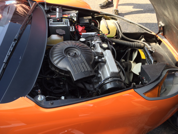

Seriously, smart car batteries are smaller than a car battery, but bigger than a motorcycle battery. It would make sense if the Elio also used a mid-sized battery. The engine size would be comparable to smarts. The smart battery is located under the passenger side floor board, so with $10 of copper wire, the battery could be placed almost anywhere.
Hate it when company place the batteries in odd places. I hliterally had to remove the front passenger tire in my Tuarus to get to the battery. Was such a pain.
