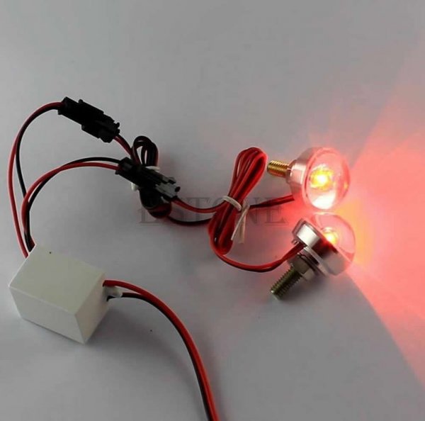

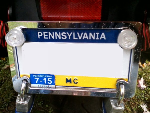

$3.29 and free shipping on Ebay.
Alternating sequence - fast strobe to solid to fast strobe etc...
They go on the license plate.

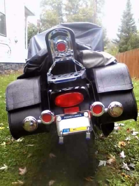

I've got a version of these strobes on my V-Star.
They're to be used in addition to your brake lights
They look yellow here, but rest assured that they're bright red.
These things are super bright and make the person behind you brake.
I just don't get what advantage the expensive "progressive" feature gives you.
http://www.ebay.com/itm/2x-Motorcyc...ash=item567307a221:g:7lEAAOSw34FVHgzt&vxp=mtr
