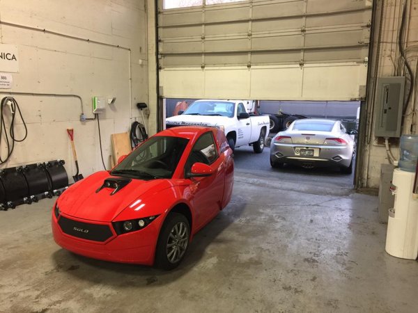

From Jerry Kroll's facebook page:
"Electrameccanica Vehicles Solo prepared and ready for shipping to Federal Compliance certification testing.
Note the added "centre headlight" for US motorcycle regs. Gives Solo a 1970's Ford Torino look!
Testing results will be published as completed."

https://www.law.cornell.edu/cfr/text/49/571.108
Scroll down and read the entire S10.17 section.
The Slingshot and the modern Morgans also have two lights "in the middle" to meet this requirement.
EM's work with the various states autocycle legislation does not change the fact that US three-wheeled vehicles (save for one) still have to meet these federal standards to be compliance certified and therefore road legal nationwide.
Some here have said that EM has reached an agreement with the federal authorities waiving this requirement. Not unlike the unofficial agreement that Tanom Motors reached with those authorities for their Invader series. However, the Tanom Invader is 83.75" wide whereas the Solo is 47.6" wide and the Elio is 66.8" wide. It is believed that Tanom Motors was given that unofficial pass on those regulations because the Invader is much wider than the other two vehicles. To my knowledge, the Invader is the only three-wheeled vehicle to be compliance certified without meeting this federal requirement. I have searched and not seen even an application filed by Elio for an official Exemption from the regulation. I honestly suspect that EM has not even addressed this issue yet and has tabled it for later attention.
Head Lamp requirements: Apparently the Solo's 2 headlamps don't meet the not less than nor more than measurement requirements and needed the added center headlamp to insure the requirements are met. 3 should make for excellent night ime driving visibility.
That's not an accurate representation of S10.17 That's just an incomplete abbreviated table.
On most three-wheelers with wide headlamp configurations the height is not the issue.
You've got to read S10.17 to see the additional requirements that are relevant on these vehicles.
