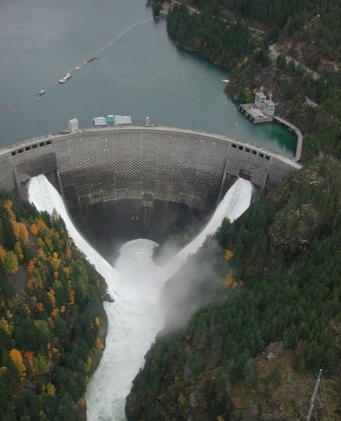

Sethodine
Aug 30, 2015
1,665
4,228
Mount Vernon, WA
It's a regional thing. Here in WA, we get about 60% of our power from hydro, with the rest being mostly coal-fired plants (we ship coal from Montana). I like seeing natural gas catching up to coal though :)
