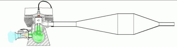

Hiperformance 2 stroke exhaust systems are critical. Pipe diameter, lenght and back pressure are tuned to keep the inlet charge from blowing right out the exhaust ports before the piston closes the ports. Which is exactly why the S2 lost power with an opened up exhaust. In the 70's I did a little tweeking on a drag racing KAW H2.
Dustoff
Apr 3, 2014
992
3,117
Tuned expansion chambers.
