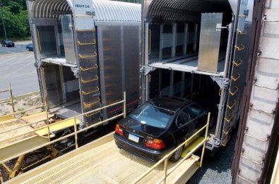

Good thinking Taz but I really don't think it will work. With the tail wheel dolly tracking the left front wheel (or right for that matter) the effective front wheel track is going to be reduced from 64 inches to maybe 54 inches. I don't think the front tires will fit the channels. I really don't have any ideas myself but I do think it would make more sense to modify the trailers with temporary center channels rather than modify the cars with transport dollys.
While just doing a little bit of digging into the transport issue I found that shipping by rail should be very straightforward as auto transport rail carriers in this country appear to have full decks so the center third wheel should not be an issue.
[Broken External Image]
However what I did discover is that doubling up front to back will be difficult on modern auto transport trailers because of the way they have to fold up to maximize car carrying capacity while avoiding obstacles such as the trailer and drive axles.
