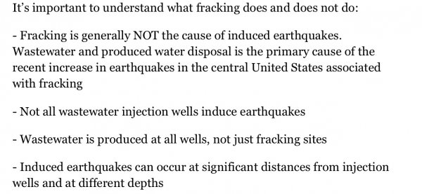

Geochemist's make important general statements regarding fracking based on scientific studies (seismology) that even I can understand:
If there is even a slight risk that fracking and other wastewater injection wells can and do induced earthquakes damaging property or chance that your aquifer and local drinking water supply may be tainted as a result of some wastewater injection wells why would you oppose EPA regulations and deny or question the scientific findings? Seems like a very high risk scenario.
