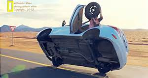

As a sacrifice to the car gods. Elio must give an offering to The Green Hell. Your suspension and handling questions will be answered.
Not a pretty sight. That is to say that a 4 wheeled vehicle being made to tip up on 2 wheels still steers true right or left readily. Tipping up on one wheel with a 3 (up front) wheel geometry automatically induces an unwanted and unexpected turning of the vehicle toward tipped wheel. Sure one can compensate for turning tendency but only with well trained lightning reflexes. The lesson to learn; design for a low center of gravity and the widest designable wheel base to keep both the front wheels down and working at all times. " No Tipping please."
Excellent point. Perhaps Elio could /should offer (not for free) a class in performance / defensive driving for the Elio.
In any event, youre point about center of gravity is important -- and should put paid to the idiots who want things like "tailgate style" doors or even gull wing doors. Keep the COG low!
I once owned a car called a Marcos, 39" high, front-mid-engine configuration (no babies conceived in a Marcos, ever!).It weighed about 1600 pounds. It could NOT be tipped or rolled; I think the COG was somewhere beneath the road!
The Elio is front wheel drive. The Wheelies happen when Rear wheel drive torgue pulls the front off the ground. It will never happen in the Elio.
The secret is out. I'll bet your not really from San Deigo. Sounds more like Rio Linda to me. The tipping I'm talking about has nothing to do with front wheel drive. Anyone else want to jump in here and make it plainer.
