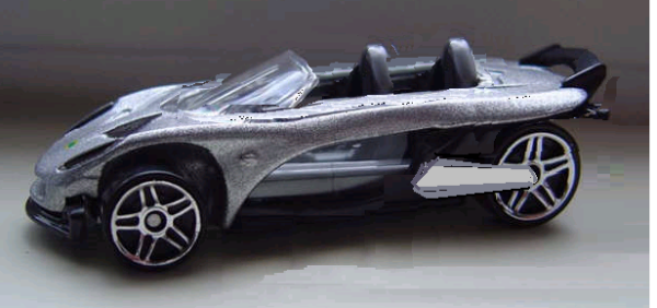

Just wanted to try my hand at a true 1.5 seater. Sort of a competitor to the Acimoto. In this case, 3 hub motors for AWD.

Looks like a Citroen front there ...
Yes it does! Didn't see that until now. The whole thing seems a reflection of what has been called the uglyist car ever made (Citroen 2CV).
What is interesting is that I arrived there just following the technical objectives I had in mind. Actually looks like a updated 2CV, with slightly, very slightly, better looks. Maybe a 2CV merged with a 1970's DS.
Speaking of ugly, That 2CV has been used for a lot of creations. Not all of them had good techical reasoning. Like 'The Reactor', which could easil-lll-ly have been a delta (with VW engine) or as a tadpole (as it was using the 2CV)
But this as completed was the worst of everything (in the dynamics of it). As FWD, with soooo much weight to the back(when two plump NAmericono's inside), and in any weather at all and it would be best to just shoot the tires out. I think the only objective in mind at all was to create a quintessential wedge shape. But justify it artistically with a few flurishes. Just as well keep it out of weather, those open wheels would toss muddy crap all over the windshield.
Art-wise, kind of interesting. Techincally, ugly as hell.
>Question is, how do the front doors open?
On the 'Bee Delivery' ? (see the logo on the door) Either they have 1) a robust hinge at front and swing up like butter fly wings, and the back slide back like my 2008 Caravan, or 2) a slight change in where the crack line is, keep front and back as one door, and fold up like the Sam Cree.
It's also possible to have a lighter butterfly door hinge for the driver. Put a small hinge (with some 3in of reach) at the top-front of the window, and a long arm link forward at the forward apex. The Avion, that my peer student built had that. (google: Avion Sports Car XPrize 114mpg)
My final conclusion on the 'Bee Delivery' as shown, it needs to have the front wheels be 6in more forward to allow the driver easier entry for his/her feet. Especially if some styles must have those long aerodynamic swept fenders.
The 'Bee Delivery' would then have some more valuable cargo space at front.
I did the body more to evaluate what the plan for the layout needed to 'bee'. (DF Bee 1.5 layout) Practically all the styles I have created up to now, for the DFS (detalidon formula-Solo) could be refitted to the 'Bee 1.5' (even with a 6in extension)
How do the front doors open and how would it compare in height to a Sport Utility Vehicle?
The real difference (to the FUV and some SUV's) is the intent for a full sealed body with sturdy doors, and a modular platform using hub motors. It is also a bit lower, so a little more stable to enable freeway running better.. The current FUV (Acirmoto) is meant for inter-city use. This would be for all-paved-roadway uses. post #545 above for the doors.
For SUV RT's, those are for sport, this is for utility delivery, commuting, etc, less HP and etc etc not sport.
OH, lest I forget, being that the modular assemblies can go into different models, that R&D investment gets spread wider, helping to reduce the retail pricing. That is what really killed the Mec-Solo off. It needed to be less than $14-15k final price. $19k+ was a non starter as a solo-seat for the wider private market.
