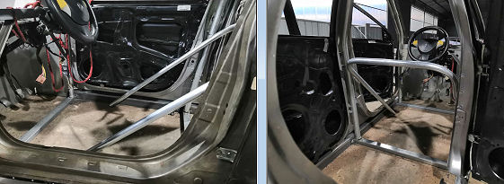

Also looking at a bracing hoop that achieves a number of things, side intrusion, main roll hoop strength, and also a bar to grab onto to get in and out of the back seat, and on bumpy roads. Can hang your telephone and rubbish bag off it as well etc.
And yes, I am aware of the critical importance of positioning that bar in relation to the passenger safety in an accident, no need to pass judgments on it just yet :-)

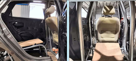

And today started working out the rear seat area, lots of room. It's not as simple as a car where the rear seats are almost secondary and hardly used, in this car it must be treated as a primary seat, often used, and by an adult seeking to be properly comfortable.

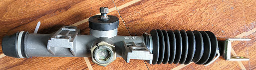

I was very pleased to remember a steering rack I looked at years back in one of the mini-vans that has sold millions. It's a 90 degree drive which is just what I need for a car with a central steering wheel. Oh and they are under $30 ... it's more involved, as you will see later, but a great find.

I tell you what Guys and Gals, and neutral gender people who identify as washing machines;
Sitting in the front and rear seats today with the doors closed and no windows (i.e windows open), is almost like sitting in a convertible, you have fresh air and unobstructed vision either side of you, what a great feeling, and I was quite surprised in a delightful way!
I was considering to have fixed windows on the right front and left rear, but not now, it is a must that all 4 windows go down.
Glad to hear – you'll have all 4 windows go down! I was assuming at least both of the driver's windows would open/close. Yes – all 4 windows down will definitely give an open, breezy feel to the travels. As an older, ex-motorcycle rider (whose wife will not let him ride anymore), I've really been looking forward to having an enclosed, tandem seated 3-wheeler. Having air just to your right – that matches the left, will be quite an open feeling while driving. Motioning to other drivers with both arms, hands (and fingers) was always a benefit while on a bike. Your vehicle will provide the same opportunity! ;)
Speaking of spaciousness. I've driven Ram trucks for the last 12 years or so. They're pretty roomy – being the size that they are. But while I sat in the "orange" prototype (many moons ago), my jaw dropped when I quickly realized that I had more space to my left in the Elio than I did in my Ram. That blew my mind and I was immediately hooked. I have no doubt how roomy your front cabin will be. It's awesome to see you putting that effort into the passenger area as well.
7,389
18,175
another very positive decision that will be extremely well received by those of us who attended shows and were able to spend some time sitting in an Elio .... in deciding on the doors, if the shifter is on the right, an elbow rest on the left would be most welcome .... for comfort one on each side of the rear seat would prove to really be handy
Yes, you can easily put your arms down both sides of the seat.
