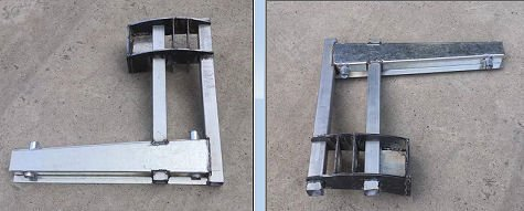

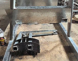

I've had a few days of silly errors, wrong measurements, got some files mixed up and lasered some wrong bits, happens every now and then, so I also took the time last night to go through a bunch of files, and trim off the excess.
So the swingarm is done, came up very well indeed, when I got the right files together that is. Easy to make, and reasonably neat looking, not that it's something that will be seen, or that you want to see.
Because the swingarm needs something to swing off, I also did the rear bulkhead.

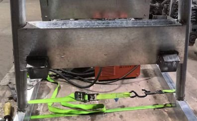

You can't see any difference from the last rear bulkhead picture on Friday, but it is completely revamped, including new laser cut bulkhead, resetting of the rear rollbar angles, and resetting of the main chassis lower rails' angles.
Happy now, and what you can see extra is the 2 swingarm pivot mounts.
