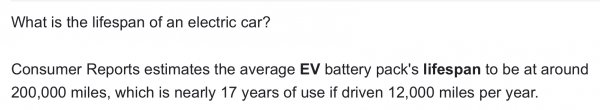

Question for you tho: When your battery won't take or hold a charge what do you do with it? Or what do they do with the old batteries? Can't just throw them away, can't recycle them, so what happens to them? They do have a charge life. And what's the cost for a new battery? This is a real question.

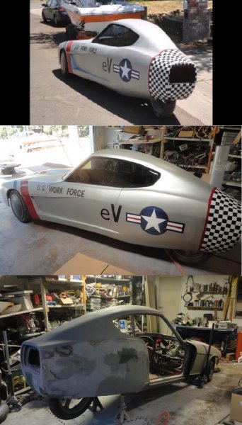

BTW, did we ever post this comparable project by Jack Murray?
Ok as an EV not completely the same. But it is a chopped body.
But why use up a 240z for this? Maybe it was a dead 240z, ya hope?
(is this a 240z body donor as claimed?)
He has adapted a Prius Hybrid to flat out EV Drive.

It is the real question with some answers below. 17-20 year life expectancy, $3000-7000 replacement cost, 60% of the component parts are recyclable. I talked with a neighbor that has owned his EV for 5 years (older battery tech) and he said the battery has only degraded about 6%.
Gas, routine maintenance, and repairs over the life of an ICE are likely higher cost than an EV when comparing the total cost to operate. Time will tell. I’ve been fascinated by EVs for a long time, but had range anxiety up until the 300+ mile range and fast charging capability. It may turn out to be the best car I’ve ever owned or my worst nightmare. So far so good. Note: The cost to replace the Arcimoto FUV smaller battery Pack $2500-3000.

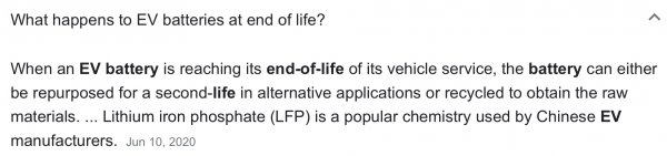

A Canadian company I have invested in, First Cobalt (FTSSF on OTC) is in the process of starting up their cobalt refinery. They are also working on recycling old batteries. Someone else will tear down the batteries leaving what they call "black mass". They will then run this though a part of the refinery to recover the metals.

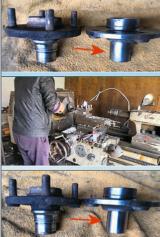

Don't panic about the delay Guys, I have been trying to work out a simpler, cheaper design method for suspension production using a different spindle (also called 'upright' or 'steering knuckle', depending on Country), and it didn't work out
Was completely my fault as I counted the number of drive splines on the CV outer joint to the hub splines 3 days ago, same number, 21 teeth, great, grabbed some used spindles complete with with hubs 2 days ago, then discovered yesterday that the spline number was indeed the same, but the diameter was one lousy millimeter different (0.040"), I couldn't believe it. My bad, I should have been more careful in my initial checking.
As of today;
I might be ok after all. The new spindles (also called 'uprights' or 'steering knuckles') I desire to use were disappointing, re; the mistake I made with the CV shaft spline diameter.
So after staring at them for a few minutes this morning, I realised the wheel hubs themselves looked similar, and pressed both sets apart. They are almost identical in dimensions, other than the donor car hub's shaft boss is 2mm/0.080" larger diameter (where it's pressed into the wheel hub bearing).
So around the corner to my lathe guy, and he promptly took the 2mm off for me, see red arrows in before/after picture. Took a whole 5 minutes.
Ran out of time tonight to see if it will work, but I'll know in the morning if it fits into the new spindles

Ahhhh, it didn't work again. The modified wheel hubs I mean.
The donor car driveshafts had interference with the other spindles I am trying. I could make them work, but it would require way too much manual labour modifying each assembly, complicating resource, and moves away from simplicity.
However,
someone suggested that the answer was likely staring at me in the face, and today I 'seen it', so will give that a try tomorrow.
Hard to explain what I am trying to achieve, but it does fall under keeping it 'cheap and simple' for production.
