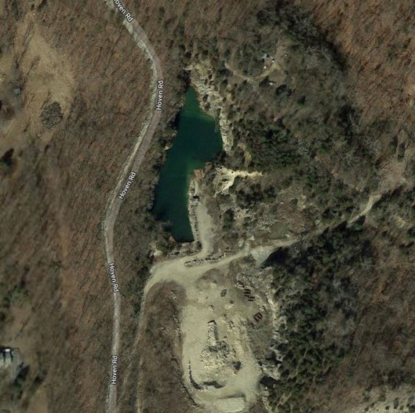

Note: I just noticed that from the satellite view of the property I'm trying to get there appears to be a giant middle finger in the lower portion of the pic. My feelings exactly for increasing taxes.
I've been looking at an old limestone quarry to build a house on. 15 acres with a 3 acre lake. They hit a spring digging for limestone and silica and had to abandon the quarry years ago, and the lake was born. It ended up being a pretty sweet property surrounded by 150' bluffs on three sides, crystal clear 40' deep lake, and the catfish living in it are as big as your leg. I'd go with solar panels and a geothermal heatpump system backed up with an efficient ducted woodstove for the really cold days. All you're running is the blower and a circulation pump for both heating and cooling with the geothermal set up, and the new ones even keep your hotwater tank hot. LEDs for all the lighting. Should be a pretty energy efficient house. Now, if I can convince my buddy's dad to sell me the property... :hail:

100% agree on the whole house generator, and diesel was what I had in mind. My current woodstove is ducted into my return ductwork, a good 35' from the furnace to protect the blower from over heating. If you get it rolling, it'll absolutely run you out of the house. Got it figured out pretty good now, so maintaining 70F is no problem, and we've got tons of oak in Missouri. On this particular piece of property I'd either have to go with a vertical shaft type pipe run, or possibly run it in the bottom of the lake. Not sure of the water temp at that depth though, and the possibility of a leak kind of scares me. Sounds like you've got a pretty sweet set up at your house though!
