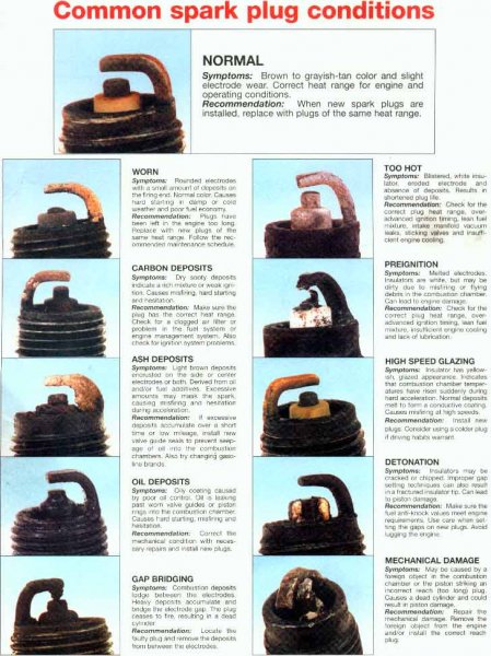

These may help:
https://www.ngksparkplugs.com/about-ngk/faqs/spark-plug-faqs/how-do-i-read-a-spark-plug
10,994
Definitely looks like detonation to me. Not sure what year your Silverado is, but "maybe" you've got a faulty knock sensor. The knock sensors adjust the timing to prevent [lessen] detonation regardless of the grade of gasoline you're dumping in the tank. Just a theory because all the plugs you're replacing are from one side of the engine. Should be one for each head. At least there was on my flat six.
