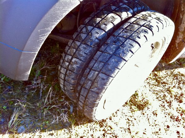

twin tire system
got them on all my cars !!

I wonder it this type of tire system could be use on the rear of an Elio .... if so, would it then become an automobile ?
My guess is they would have to turn independently. Otherwise considered duals.
Would they have to be independently suspended where each moves up and down independently of each other?
good question .... I don't know that there would be any advantage to having dual tires on the rear of an Elio but it is an interesting thought
7,387
18,174
I think mud and rocks would simply get stuck between them.
I have been driving a dually truck since '02 and I haven't had any significant trouble with that .... not saying it can't be a problem, I just don't know .... the wider the rubber footprint the less the ground contact pressure .... I can see that might reduce traction required to keep the wheel(s) from sliding sideways in a turn
