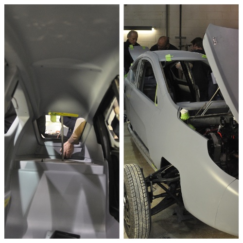

per Elio Momentum v24:
"Interior Upgrades
Body styling has always been important for catching the consumer’s eye. But, the reality is, people spend their time in the vehicle. Over the last decade, automakers have put more emphasis on interior styling, amenities and functionality. Elio Motors knows the interior will be important to our fans and customers. We’ve made some nice upgrades on the P5 that are likely to help differentiate the vehicle when we reach production.
Most of these changes are very subtle, but they’ll make a difference in comfort and convenience:
    • The arm rest on the door was raised;
    • The rear seat was lowered to create more passenger headroom;
    • Additional foam was added to the rear seat for a cushier feel.
We also upgraded the instrument panel for better aesthetics:
    • A redesigned iPad holder;
    • The A-pillar shape will be less intrusive; and
    • Brushed metal was added to the dashboard to provide a more modern look.
None of these changes are revolutionary, but each one helps add up to an improved driving experience for both the driver and the passenger. It also shows just how many small engineering details need to be considered on the road to production."
