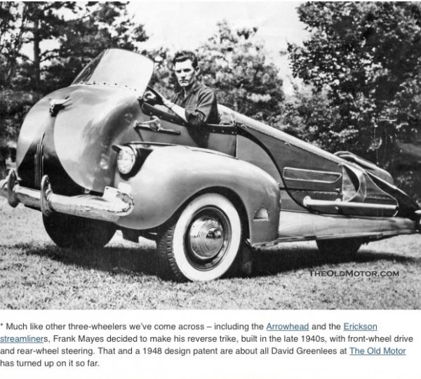

Very beautiful design. It only had one too many rear wheels ;)
Also, there is this late 1940's reverse trike with front wheel drive and rear wheel steering! Grandpa Elio probably showed this photo to Paul years back and the vision stuck in his head.
