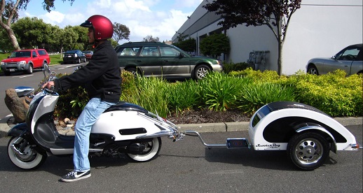

I was going to ask what was the lightest and smallest trailers that were freeway ready.. But I guess I found it..The ScooterBug
very nice finds .... it was interesting to see how they attached the hitch frame to the bike in the picture of the zm1800rtrailer
