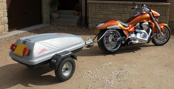

very nice finds .... it was interesting to see how they attached the hitch frame to the bike in the picture of the zm1800rtrailer
Jim
without seeing how the body attaches and the space available, I can't tell for sure ... but in looking at pictures below of an Elio frame and at the way the trailer hitch is attached to the bike, I can see how something like this might work .... this method has no connection to the rear tire's suspension and uniformly divides any pressure to both sides of the Elio's frame

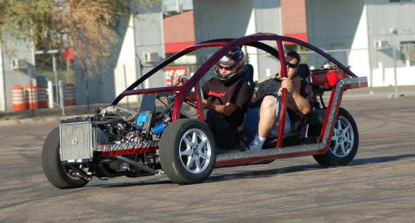

FYI... These are some nice views of the completed P4 chassis and the rear end should be pretty close to what we see in the production vehicle.
[Broken External Image]
I agree that it should not be too difficult to design and mount a hitch in a way that distributes the load appropriately while also avoiding any interference with the rear tire and suspension assembly.
As the tail lights are immediately above this location making a simple pass through wiring harness for brake and turn signal functions should not be very difficult. Hitch kits will also either have to include a replacement rear skirt or require cutting the existing fender skirt below the license plate to allow the hitch and wiring to pass through. None of this is exactly difficult and aftermarket hitch companies are used to most of this with the exception of the fender skirt issue however making a mold of the current rear skirt and modifying it to a allow a hitch to pass through should be fairly straightforward.

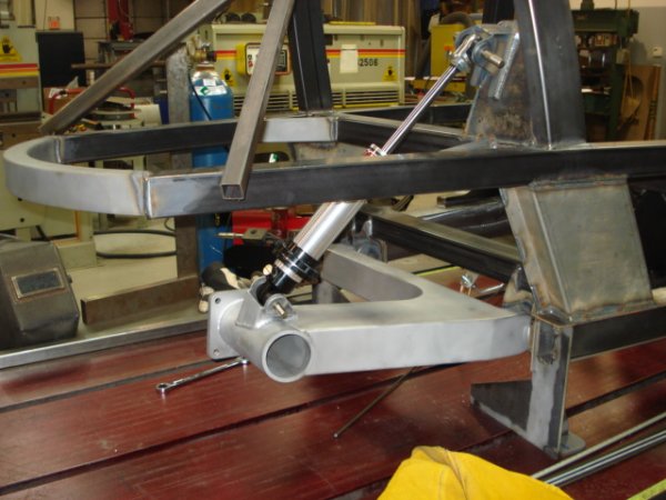

I know EM has said they will definitely include provisions for being towed as they are well aware of this vehicles great potential in terms of the motorhome dinghy market however I have not yet read exactly what these provisions will be.
I also do not remember seeing any great photos of the naked front end but these are what I can find that show at least a little bit of this part of the vehicle:
7,389
18,175
thanks, the pictures help .... I believe plates can be attached to the bottom of the front box tube and slots cut in the screen shown below .... I'm unsure if bracing will have to be added to the front box tube, Elio's designers will have to figure that one out .... without additional braces, as a pure guess I tend to believe the additional parts would add 5 +/- lbs to the vehicle and shouldn't add any measurable degree of wind resistance .... it certainly appears to be doable
