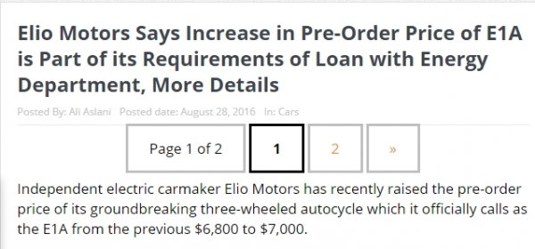

Article rehashing ATVM, and 2016 Gateway Conference.
The new part is the last paragraph calling Elio a three-wheeled masterpiece.
http://masterherald.com/elio-motors-says-increase-in-pre-order-price-of-e1a-is-part-of-its-requirements-of-loan-with-energy-department/44507/2/
We all know the Elio has potential to be a three wheel masterpiece after the engineering specs are finalized, E's built and tested, tweaked, and reveal of the production Elio.
What I didn't know was that Elio Motors was an independent electric car maker.
I prefer to read actual test driver reviews, which have been less than positive. We call the auto critics hacks or Elio haters if their reviews are less than favorable. If we don't think the auto industry critics are credible, I propose we solicit EM to allow 2 of our Elio Forum members and reservation holders to test drive and write a review of their Elio performance and handling experiences. Coss and Ekh would be excellent candidates for the first EM invitational reservationist Elio ride, drive, and review event.
